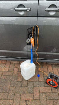

With me having not driven any miles or in fact switching the engine on with just petrol in the tank, and then only driving 6 miles with the mixed fuel, my thinking is that if I now syphon off say another 20L of the current mixed fuel tank and add 400ml of the 2 stroke mineral oil plus then top up with a fresh 20L or premium diesel then I should be ok.

If you're going to take 20l of the contaminated diesel out I'm curious why you don't just take it all out?
I get that fuel is expensive right now, but so are engine rebuilds.
I’ve ordered a syphon but I’m not sure where I’d put 80l of mixed fuel tbh. How I could dispose of it safely. I’ve a tree stump that needs to stop sprouting so had thought 20l could be used there to kill birds. :) I think 80L would see Greenpeace and Swampy at my door!!
Do you know anybody with an oil fired boiler?
the diesel tank has an anti syphon trap.

The OEM guidance is to drop the tank and flush,
there are mobile companies that will do it roadside,
the AA and RAC also provide this service, ( might be worth a call?)
