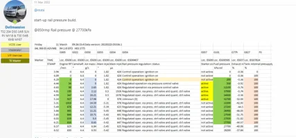

whats the rail pressure when cranking? - via VCDS.
@mmi is very good at reading block map data from VCDS.
here is my chart of HP rail pressure,
see @mmi guide here:
and here:
