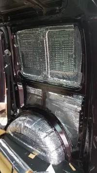

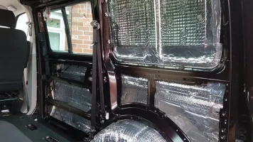

Nice work @warren. What materials did you use?Sound proofed to within an inch of its life. Just got drivers side done, stopped for some lunch!
How thick is the silent coat and will you be doing the floor with it?Mostly silent coat and a bit of the MVM sound proof roll. It's very similar to the silent coat.
Cheers pal. You've got a lot more material covering your panels than I have and I had it done by a professional company which has got me looking into this sound proofing a lot.Both the silent coat and MVM stuff are 2mm. I will have enough to do the floor so yes. I got a bulk pack of silent coat and 10m roll of the other stuff which is 0.5m wide
@T6 Dave's Dad It was not a dig at him or criticising his work as I've already said he has done a good job. It was a question in to the effectiveness of sound proofing and the differences between how it's done.@Twoguns All I can say is that @warren has done what many non-professionals do which is to saved on labour, invested in extra materials and knows exactly how the job has been done. He has also acquired additional skills and knows the job has not been spoilt by skimping. So we'll done, nice job so far @warren.![]()
Cheers @slidepods thats the type of response I was looking for. I've taken the panels off inside and although it's certainly not over kill I'd say around 80% has been covered with Skinz and the tapping panel test does give a nice solid thudding noise from the outside. My main concern with my lining package is the amount of road noise I still have and think it's due to the wheel arches were not lined with anything other than the carpet so think the noise is still coming through there.when we were looking at where the soundproofing should go in our installs we took the tapping the panel approach, As time went on we had the luxury of experimenting and test drives on many many vehicles along with swapping tips and techniques with our friends in the industry like the boys at UBER and CELTIC which has led us to the exact amount we put in every time. This is obviously not something the DIYer can do so I definitely recommend the overkill approach there, It works and gives you a warm sense of achievement when you stand back and look at your work!![]()
