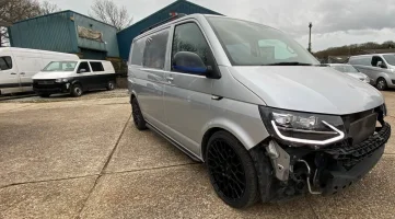

Team Silver - inaugural post!
Had the T32 Shuttle for a few months now and been thinking about where to start. This thread has been a great source of ideas!
Decided to start with ride height and wheels (I accept not very original!). Really grateful to @CRS Performance for the advice on suspension and providing the Koni shocks and H&R springs. Steve recommended a 40mm drop with the shocks for family comfort and the advice was spot on! Has totally transformed the ride! Posted overnight and easily fitted by local garage last week.
Then took off 17” Devonports and put on 20” HSTs in Smoked Chrome over the weekend. Really pleased with the results.
Now to plan what comes next!
16D56583-2345-43A3-96A3-7E27FD7FE469.webpC828C8AF-4B88-4B9F-8117-5B9825C8C4CB.webpA5D5ABC1-1F94-4045-A0C6-01C817BCD3E7.webp67675CED-1F9E-4B47-8D78-02CDFA5E6CB0.webp
Well done yes the stance is spot on , looks great and comfortable as a result . Still our biggest seller by Far and as long as the factory keep up with the supplies it will continue to be that way . ,
