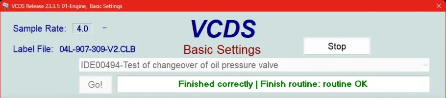

How about this link (post#23)Is this it??
Yes, correct. However, you should check their response to the oil pump PWM signal duty cycle - e.g. picture 4 in post#1 - by quickly flooring the throttle you should get a momentary high pressure switch closed.The engine running I have low pressure switch closed and high pressure switch open.
Engine off I have both switches open. Can anyone confirm same?
