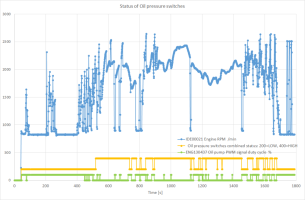

This is the downloaded file but I don't know how to see the graphics. Thanks
  • LOG-01-IDE00021_&3-1.CSV
Reactions: mmi
Keep leftmost TIME STAMP column (as X-axis). Hide or delete others. For oil pressure switch statuses replace OPEN with value 0 and CLOSED with value 200. Create a new column which is sum of low and high pressure switch statuses.
Select columns:
TIME STAMP (will become X-axis)
Engine RPM
Oil pump PWM
Newly created sum of oil pressure switches
Create X-Y plot
Thanks, I already have several records. I'll try to get the graphs. Samd remember the location of the valve. Does it change up or down?
Thanks, do you see something wrong with the graphics?
Well, not sure about wrong but the following are different what mine is doing:
  1. At engine start-up your engine does not raise oil pressure to high level (orange line) (compare with post#1 picture 1).
  2. When revving the engine your engine does not raise oil pressure to high level (orange line) (compare with post#1 picture#4). Interestingly also green "dips" are missing - thus perhaps didn't even command higher oil pressure
However, during your journey the behaviour seems to be as expected - green low (at 0) > orange high (at 400).
There are similarities with @SamD 's data - perhaps the oil pressure regulating valve is seizing occasionally (cold?)??

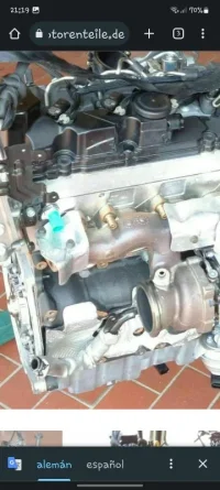

To help the green pressure sensor is in the back covered with a cloth. The brown sensor next to the filter and the oil pressure valve is below covered by the alternator Screenshot_20230121_211955_Chrome.jpg
