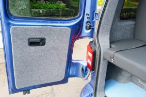

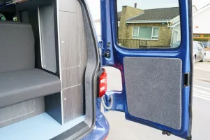

Made ply panels for the barn doors and carpeted them -
34949283615_1bafb65a58_h.webpVWT6-2.jpg by VW T6, on Flickr
34785790432_5fb0999386_h.webpVWT6-3.jpg by VW T6, on Flickr

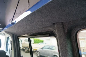

I then made plywood trim pieces to finish off around my pop top frame. I carpeted these and fitted them using super sticky velcro. Seems to have worked but will see if it lasts -

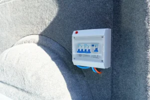

240V fuse box wired up and attached to the trim panel behind the tall wardrobe

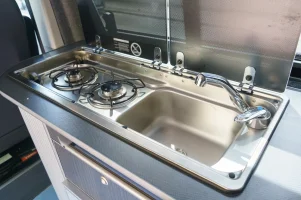

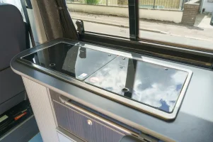

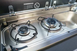

Hob/Sink fitted and connected
34247714104_1a634dcedc_h.webpVWT6-2.jpg by VW T6, on Flickr
34247715614_d01a670cf6_h.webpVWT6-3.jpg by VW T6, on Flickr
34927221432_0e8de86cd7_h.webpVWT6-4.jpg by VW T6, on Flickr
