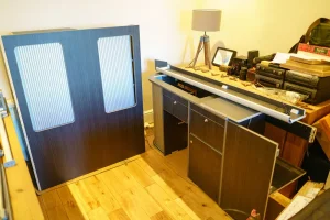

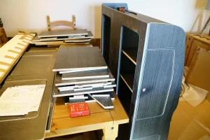

My Evo Motion kit arrived and I built it over the last two nights. Issues encountered -
Wrong instructions sent with package - Correct instructions emailed but hard to follow/poor detail
Recess holes missing from tall wardrobe end panel
Worktop cut for wrong sink/hob
Worktop raising panel hinge hole in wrong position
Catches missing for flap down drawer and sliding drawer
Overhead locker boards are incorrect meaning the door closes flush at one side and is a whole thickness proud at the other
Rear panel on sliding drawer is too high
Evo Motion have alreadty agreed to send the correct tall wardrobe end panel but I spotted the rest of the issues last night so will have to phone them Monday to sort.
Issues aside and poor instructions aside it really is a nice piece of kit once its together. Just a bit annoying I need to go through this hassle in the mean time.
Ill post photos once the replacement parts arrive

Spoke to Evo Design today and thought I would post an update to my issues as they have been very helpful and it seems only fair I note that for people that are reading this going forward -
Recess holes missing from tall wardrobe end panel - New panel being cut and sent to me. It was an error on their website where it said this was included and they are providing for free due to that error (normally a £30 upgrade)
Worktop cut for wrong sink/hob - Apparently its the correct cutout but there are little timber pieces that you add which wedges it in place - Would have been nice if this was noted in the instructions but at least its sorted
Worktop raising panel hinge hole in wrong position - This is apparently the way its supposed to be i.e. one hinge is further inboard than the other - will try tonight and see how it goes - hopefully the issue is gone
Catches missing for flap down drawer and sliding drawer - angle catches provided for normal drawers - you are supposed to hammer these flat for these drawers - again would have been nice if that was clearly noted in the instructions. Apparently theres a video on their site somewhere showing this - I havent found it
Overhead locker boards are incorrect meaning the door closes flush at one side and is a whole thickness proud at the other - Seems like the pre-drilled holes are incorrect but I will be able to drill my own holes and sort to save new parts having to be cut
Rear panel on sliding drawer is too high - This is the way its supposed to be im told - doesn't reflect what is shown in the instructions but not a big deal
So one new panel being sent to me by them due to a mix up at their end and a little bit of alteration of existing parts by me at this end and all should be well
