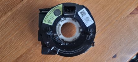

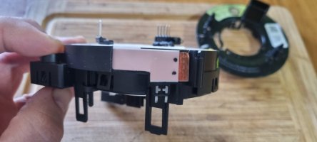

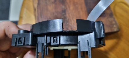

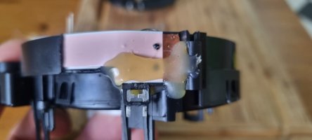

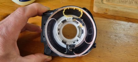

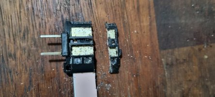

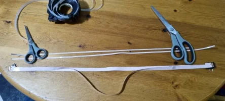

I needed to bring power supply to my heated MFSW(+12V & GND).
To do that, extra two tape conductors are needed in the spring clock.
T6 OEM Steering Angle Unit 6R0959654 combined with the spring clock tape has 6 conductors. Unfortunately there are no spare paths.
Even if they were, they wouldn't be able to handle the current requirements of MFSW heating element.
I am not aware of any OEM spring clocks with heating tapes to be compatible with T6,
so the only way forward was to extract OEM heating tape from any other heating spring clock unit and add it to the T6 unit.

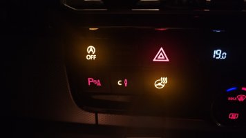

For a time being, until a proper cold season, I am going to use approximately 1 minute heating time.
I can adjust the time to virtually whatever I want.

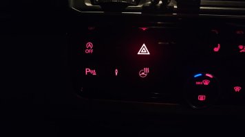

Today was the day! Everything is installed and heated steering wheel work.:mexican wave:
Thanks to @DJ821 for the graphic it looks perfect! :thumbsup:
I used a timer relay 0-120min so I can set how long the heated steering wheel stays on

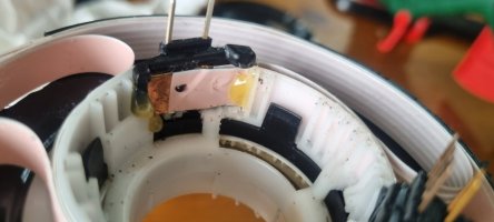

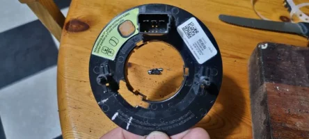

Surprise surprise… My clock spring cable for heated MFSW broke and destroy my clock spring totally….
Now I get some trouble with my new clock spring but I think I should do a second try soon…

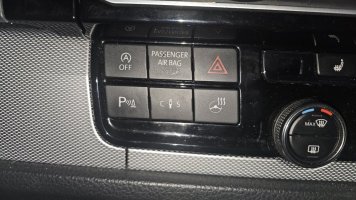

@Robert Very nice work, thank you for sharing all information. I just started my clock ring conversion I hope I am ready before colder days are coming. Would you please tell me where did you find the switch with the heated steering wheel symbol on it?
This is a DIY switch cap!
You can either buy a switch, paint the cap and then laser it.
Or you can buy a switch and use your blind cap from your dashboard, laser it and edit it so that it fits on the switch.
I chose the second way.
Or you can buy a switch and use your blind cap from your dashboard, laser it and edit it so that it fits on the button.
