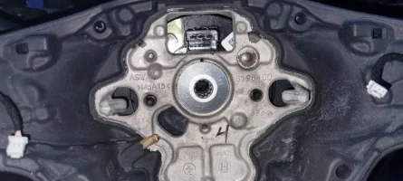

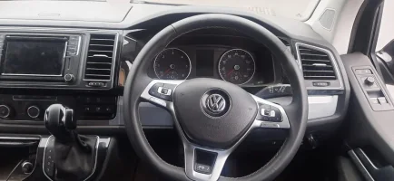

Hi what wheel is this from and how are you going to control it please? This is awesome i definitely want this!!!I have just fitted a heated steering wheel to my t6. Can anyone help me find a clock spring that will work. I have a way of controlling it already
Hi thanks for your reply. I have a 2016 T6 highline manualAt the Moment I am struggling to find a clock spring. I have just found a way of modify the standard t6 clock spring.
I will show you the control when I have made the clockspring.

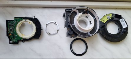

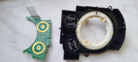

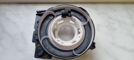

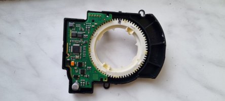

Look what I have discovered on my own MFSW.I have upgraded my MFSW to flat bottom with DSG paddle shift few years ago and I didn't think about heated version then.
VAG uses few control/activation methods.
Some heated MFSW use dedicated button on the wheel itself and some others use HVAC controls via infotainment controls.
Interlinking driver seat heating and MFSW has also been done by VW on some of their vehicles(Jetta).
The challenge would be to match combined heating elements resistance to be within acceptable range. Than next thing would be resistance range of thermistor/thermistors. And final and most important, steering angle unit would need to be able to provide extra connections. Two for MFSW heating element and possibly another two for thermistor.
