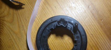

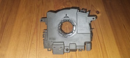

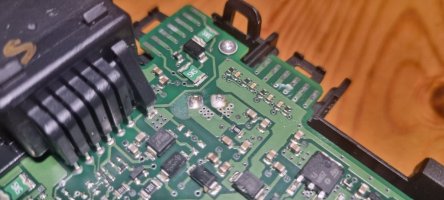

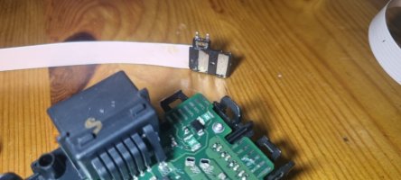

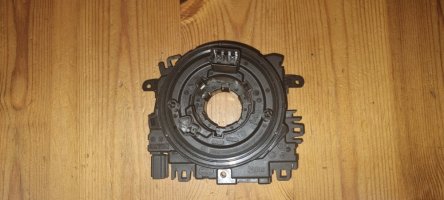

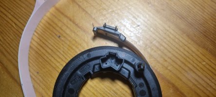

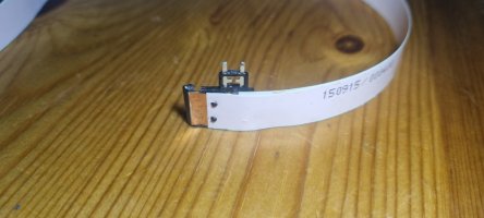

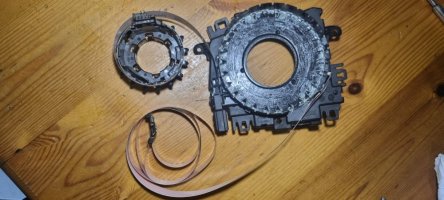

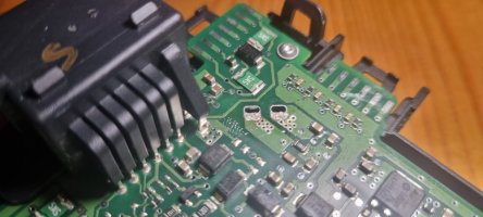

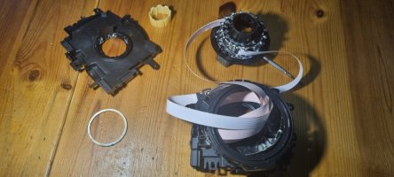

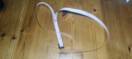

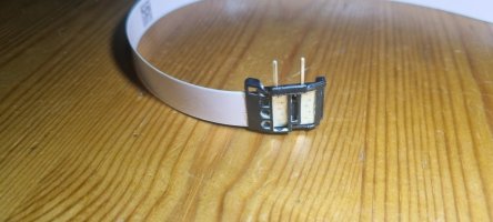

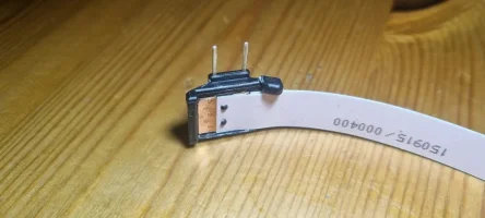

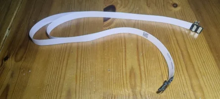

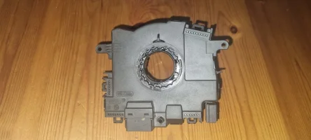

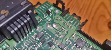

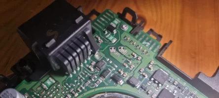

Another small bit of progress.
Disassembly of a "heated" clock spring.
Removal of heating tape(it is actually two tapes wound on top of each other).
First, tape detachment from the centre ring.
Second, tape desoldering from the PCB.
20221002_201059.jpg20221002_202125.jpg20221002_202606.jpg20221002_202659.jpg20221002_202759.jpg20221002_202815.jpg
And the final result of the operation "heating tape removal".
More photos to follow soon :cool:
