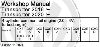

the workshop manual states that after replacing hpfp and rail the learned values need to be reset
Well, the workshop manual states "system EDC 17" - this ECU is not used on EU6 engines (CXHA etc.).
In the updated workshop manual (edition 11.2024) the mention to "reset learnt values" is removed. Just fill/bleed fuel system - the end.
