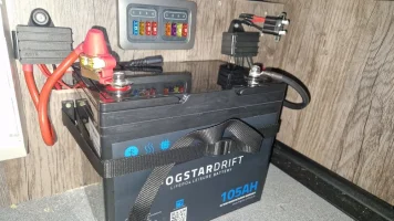

Just be aware that the Fogstar BMS can't see any draw under 1a so if you've got something small running constantly there battery BMS won't be accurate. Only a shunt will show the true state of charge.For those who remember my attempts to trace what was discharging my previous lead acid battery:
This is after a week without any charging. It's a different world! Driving is usually the only charging necessary and I tend to leave the charger off when on hookup.
Anyone thinking of going lifepo4 - just do it.
