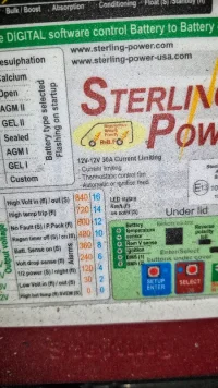

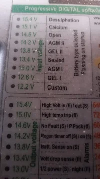

1 Sterling Power management system.

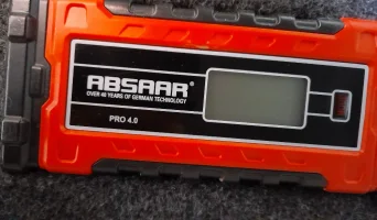

2.Absaar 4.0 pro battery charger.

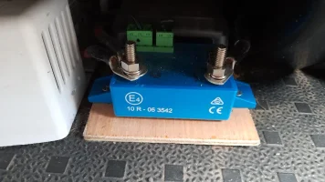

3.Victron Battery Protect 12/24v 65A

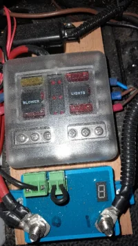

5.Fuse Box.(Near leisure battery.

Straight swap, I reckon. It’s not like you’re telling the ECU that you have a new/different battery so that it adjust the charging or cycle count accordingly
Any ideas which charger to change absaar with & is changing the Sterling profile easy enough?
