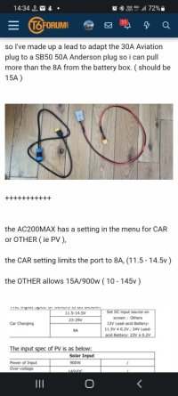

I made this cable .
" Anderson 50A plug to XT60 with 12awg silicone cable"
That plugs into another Anderson plug in the van.... That's connected to th LB via a 50A midi fuse .

You can also use the 12v plug cable that come with me it.
That works.... But the connection gets warm after a while.
That's why I swapped over to the hard link.
Try it and see how you go.
