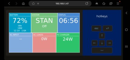

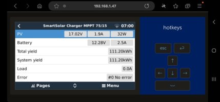

I've been noticing that my panel isnt charging the battery when its sunny in the middle of the day. I know this sounds odd. It does however charge in the morning. I get between 10 and 12v from the solar panel but no Current.....
I disconnected it from the Victron MPPT yesterday and the panel was showing 10.5v.
So whats the best way to trouble shoot this ? could the panel have a fault and only works at certain sun angles ?
The Victron MPPT needs to see 5v more than your battery voltage in order to begin a charge cycle, then (I believe) 2v higher to continue it.
10v isn't enough to start or continue charging, which is why it's not charging.
A panel has a higher voltage when it's colder.
Do you know the specs of your panel? Wattage, open circuit voltage and closed circuit current?
