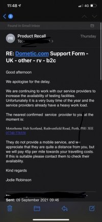

Just wondering if anyone has had any update on the situation? Coming up to 8weeks now since initially registering that I have one of the affected units and have had no further updates since! Had phoned 3 weeks ago to chase it up and was told to register a complaint and that they were still trying to set up a service centre and testing procedure for the faulty units

Just phoned and managed to get it booked in for Thursday. Should take about an hour. They don't do weekends I'm afraid. There's also a guy in Falkirk that will come to you to get it done so maybe worth giving him a bell, I tried him but he was still waiting for dometic to send out the tools he requires
If getting a hob looked within a reasonable time is causing a problem, perhaps Dometic might allow you to appoint your own gas engineer to perform the check and refund your out-of-pocket expense for it (I assume it's just a gas check and nothing that requires a Dometic specific test EDIT - just seen the previous post about 'tools' so perhaps not).
