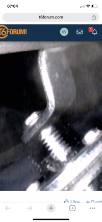

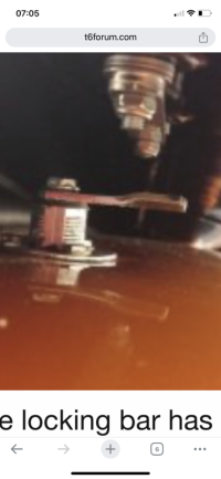

I have the Aurora lwb. It has failed 3-4 times now, but after the first 2 times I secure with a strap as well as latches.The latches aren’t strong enough, maybe if they were cast instead of stamped they would be better. It’s in high wind and when passing lorries it fails, the pressure pulls the roof up and bends the latches. You can see in the photo how much more bent one is than the other, you can also see the one that’s more bent has happened in two stages(the rub marks have changed position)
Skyline deny there’s a problem but they should really think about a solution.( Ie if the latches were cast instead of stamped metal.)
View attachment 230692View attachment 230693

I don’t understand what either of your points are. The title of the thread is aurora pop top opening on motorway. I have tried to be useful and shared my first hand experience of this happening. Just the facts, with photos to back up.
Neither of you have commented on which style of cam you have, are you aware there are two types ? You can see in the photos mine is the dog leg latch style. Which has a shorter cam. There is another with the shaft on the cam longer and a straight latch. It could simply be that one is better than the other. Maybe they don’t produce the one with the straight latch anymore.
I have one of these fitted on a £40k van and obviously don’t want to impact the resale value. But its easily fixed one way or another either bracing the dog leg latch or replacing the cams with the different style. Hoping that you never encounter the conditions to make it pop is up to each owner, but I hoped there might be some tech savvy people that would have something to contribute.
