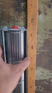

Some have hacked the doppler simulator required for calibration from a table fan, and maybe even possible to use VCDS. Not sure if anyone has done this with T6 and tbh looks bit tricky.
Afaiu thats correct.
I did this last week! vcds helped me! drive2.ru has written a lot about this! the distance from the fan to the car should not be 1700 but about 650mm! it is necessary to look at the signal power value in measured values, the value must be at least 80%, after that the calibration can be performed
this is a good post on the subject!
