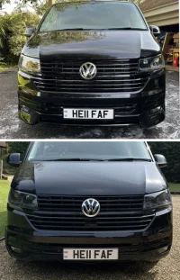

After a third incident with the spoiler in as many months whilst waiting for my body shop slot it actually ripped off on a grass verge when turning in the road……..then went under front wheel however now it was stuck so then had to drag it along road and drive over it with rear wheels to get it free.
Other than road rashes it is in surprisingly good shape.
Am thinking I will not put it back on as whilst I like look of it it doesn’t seem to fit with where I travel and how I drive however let’s see how i feel about front end once washed and the remaining adhesive is removed AE1EF6CF-1354-4C08-AE61-C8A49FFACDB1.webp
