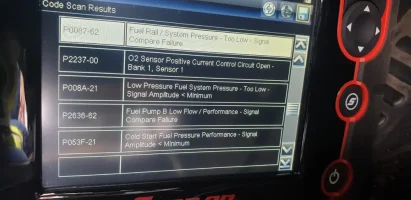

Well, in sinister HAL 9000-fashion, my car has just decided to take its revenge for me having the temerity to consider getting rid of it.
We're currently in Northumberland (about 180 miles away from home) and tonight, on the way back from dinner, the car started to misfire (as if being starved of fuel) and then it went into limp mode. It was dark, we were on a narrow twisty lane in the middle of nowhere and there was no mobile signal - great!
Fortunately, I managed to nurse it back the 9 miles to our accommodation, though it was sounding dog-rough by the time we arrived. I'll be calling the AA first thing tomorrow and, as I have National Recovery cover, I'll be able to get it & us back home if they can't fix it at the roadside, but I fear that's the end of our holiday. :cry:

Just had the local breakdown guy round to look at the car - job was handed-off by AA (presumably due to location).
Injector 1 was "weepy" and when it was disconnected (whilst the engine was running [like a bag of spanners]), it had no discernible impact Also tried disconnecting injector 2 and there was a noticeable deterioration with that one. Given the repair cost is probably not that bad, it's possible that the old girl will live on.
