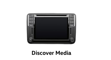

The nav on my 2018 T6 keeps stating 'Navigation database not available' despite trying 3 different VW SD cards and also trying a soft reset by holding down the on/off switch. Has anyone else experienced this problem and managed to resolve it?
Just a thought, and please take this the right way, but you are using the correct slot (left hand one) for the card?
Thanks Nige. I’ll be honest, I didn’t think it mattered and the dealer who sold the van to me actually put the original SD card into Slot 2 and it’s worked fine until last week. I have, however, tried the several SD cards I now have in both card slots and soft reset each time. Still not resolved the issue.
Was it working until you took the card out?
the card goes into the left slot assuming you have this unit - well I have always used this one and just assumed the right hand one was for music files etc. Happy to be corrected
It doesn’t matter which SD card slot is used.
Have you tried a normal SD card with music on it?
I’ve had MIB units develop a fault which stops them from being able to read the Nav data. Sometimes, a software update can cure it but not often.
Lastly, do the SD cards have the correct Nav data on them?

Just suddenly stop working for no reason. Turned the ignition on, opened Sat Nav, put in address, GPS working, calculated route, started directions and then literally as soon as I set off that message came up on the display. I have done a fair trawl if the internet before posting on this forum and it looks like it is a common problem on VAG vehicles (Audi, Seat, VW Golf (interestingly no Skida’s apparently)) so don’t know what to make of it tbh.
Slot 2 on the right is the correct slot for the nav database !!
