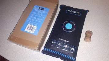

Arrived this morning and straight in the van.
My windscreen tends to get pretty damp inside as well but I don't think there's anything sinister going on - I just put it down to the cold. By coincidence, I had a couple of those 1Kg dehumidifier bags arrive in the post this morning and after thoroughly drying the screen (wiped with a towel, left the engine running for 45 minutes with heater on max, A/C and heated screen on), have now stuck them on the dash. I'll report back in due course.

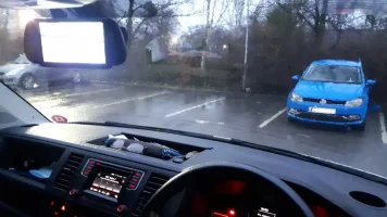

I thought I'd give you an interim update as the dehumidifier bags have been in place for about 5 days or so. One on the dash and one towards the rear.
It may be a coincidence, but the screen has been clear of moisture even after having a dumping of snow on it for a night and a day and after a long cold damp day parked at work today.
This pic was as I returned to it this afternoon prior to driving home - taken before using the wipers.
