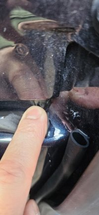

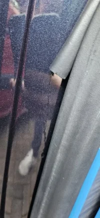

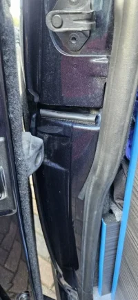

After lots of checks and adjustments of the door seal, I noticed on the mechanism that slides into the side of the van, on the rear panel, water leaking from behind the sliding door runner cover and down the pillar.
This in turn was being drawn into the rubber seal and then flowing all the way down and along, until it leaked into the van at the point where the step should be.
My fix was to simply use some excess 'Shuts like a Golf' D shaped door seal that I had left over, and therefore channeling the water away from the actual door seal.
And all sorted, no more leak and no more condensation.
