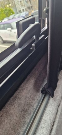

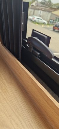

So just found a little hack...maybe others have found this before me haha..so 1st pic is the locked windows, then just found a little space to lock the latch in safely for driving (2nd pic) :)
View attachment 285098View attachment 285099

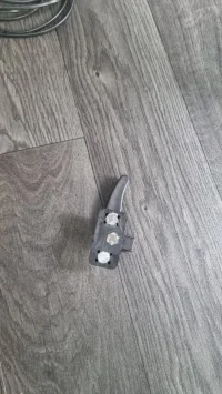

Anyone had a handle just fall off?! Mine parted company with the glass as I was driving home from work today. Not sure why, looks like wharever thry used to bond it just wasn't stuck properly. Not thrilled.
Excess heat + vibration from driving?
Not seen that before/ yet.
You had them 12 months yet?
Faulty goods
All our items are covered by a 12 month limited warranty unless otherwise stated
I mean it's been warm for oop north, high 20s but nothing excessive. No harsh vibration, driving through town so no more than 30mph. It just gave up. I've dropped CamperGlass/THQ a message, window is less than 3 months old and has been fitted for around a month. I know it'll be covered but that means I'm still out of pocket if I have to pay installer to have original taken out so it can be replaced and van will be off road. This is my daily.
No don't worry this is exactly what happened to us...they will send you the glue it's easy to do yourself....so that happened then a few weeks later went in the van an the other handle on the same window fell off so had to do the other one too...both times they sent the glue..I think the original adhesive wasn't done correctly...the safari window on the opposite side of our van touchwood has been fine
Same our van is our daily van...won't need to come out just new adhesive put on
Awesome. Hopefully as easy as that sounds. Love the window. Glad it's something that sounds like it can be sorted without it coming out!
