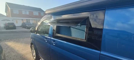

Just wondering if anyone has fitted these with Vanshades?

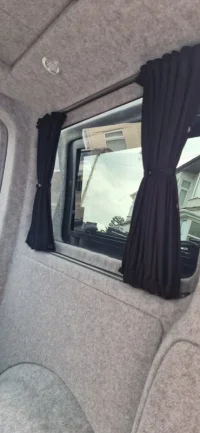

We have gone for the curtain on the rails rather than the vanshades. Few reasons, the price and also the I think with vanshades the outa part comes in abit so for us we went with the curtains...but either look great...I haven't seen any safaris with vans hades but I'm sure they will fit

We have just gone for the blackout premium curtains on the rails...really good and look nice tbf...vanshades look brill I just (personal opinion) think the outa part takes out alot of the window space...but either look great

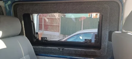

Just had all our windows fitted around the van and fully carpeted...electrics ready for the next step

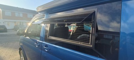

Opted for the Safari windows on both sides and wow they look amazing!!! So glad we went for these. The size of the window opening huge, looking forward to the next trip.
Just got to watch your head on them when you walk outside the van
Sure I passed you M6 southbound on Sunday, I was admiring the windows, defo next think you do replace solid sides with these
So we went for it this weekend, managed to get one window fitted, removing the old window was a lot more involved than I expected, surprised the wife didn’t file for divorce during the process :laugh:. Glad I bought some new window trim seals as they got destroyed removing the old window (edit: thanks to @TeeCeeJay for the heads up on that!). Anyway it looks great and opens up a lot more than the old sliding window. Still got the sliding door to replace, that’ll be in a few weeks.

looks great they are so worth it
Love the open lock position for camping :)
