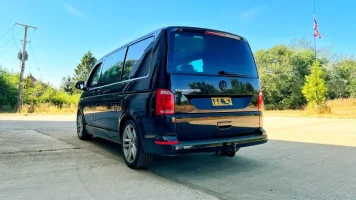

Got a pic please @Skyliner33 ?
Was/is yours a PV? Maybe the OEM suspension differs between PV and Kombi?

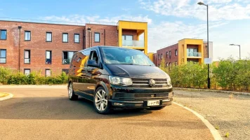

In some photos my van looks to have much more than a 10mm rake… there is literally only the 3 seater bench in the back, plus the towbar and spare wheel of course.
