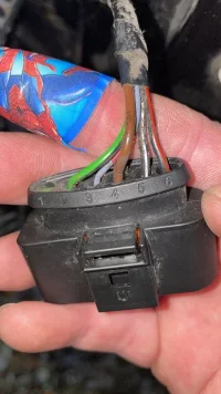

So....reverse camera fitted.
Video lead into head unit
Pig tail live and neutral off live behind head unit
Reverse from Alpine fitting loom connected to reverse from head unit
Live connected to reverse switching live on rear cluster (2 in photo)
Neutral connected to 4 in photo
Head unit is now flickering under ignition - camera works
Engine on and camera flickers and stereo flickers/switches off
Any ideas?

You do not connect the camera to the reverse wire. Run the power for camera upto a ignition live or to the red wire on back of the alpine .
this will give you the option of rear view when driving as well as reverse ..

Done and working! Thank you
What the headunit ?
if you just joined the red wire from the camera to the red wire on the alpine harness this will have no affect.as it’s switched
What the headunit ?
Yes, I didn’t make any change except the live to camera behind head unit. Bizarre
joined to that red wire in the picture above with the rubber insulation? If so that’s correct, and that red wire is not connected anywhere else ? Except the camera
