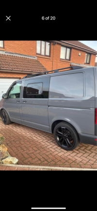

First job poptop (there’s roof bars with a fixed solar panel - not connected to anything), considering our options there. I’d like something like stealth b2 my husband is keen on austop reviews. Visiting companies over the Easter holidays.

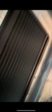

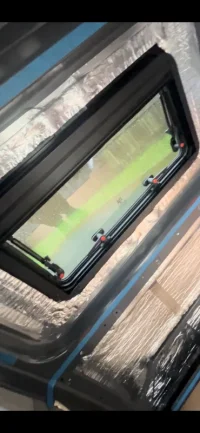

Are those the transporter HQ safari windows? Got any better pics from the inside please?
TeeCeeJay is right. They are trade glass. I’ve done a bit of a video but it was harder than I thought to film one handed haha! They are self supporting and you can fix them in place. Vent option also. Black out blinds fitted.

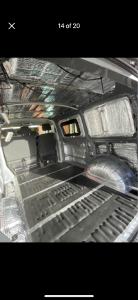

  5. Completed insulation and carpeted
Nice! Although not sure why you'd replace a rigid solar panel with flexi? Fitting issues?
Also you'll want to remove that crossbar, any big shadow on the panel will basically reduce your output by about 80%.
We wanted the flexibility of using a roof box if needed. Also we were told the rigid one, that we had, wasn’t ideal for poptops.
Will look at removing the bar - thanks for the advice
