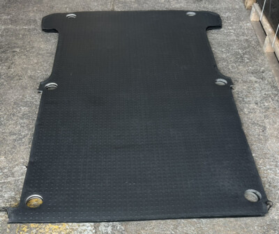

I'm coming at most decisions here from a function over from point of view. As I mentioned above, our adventures can tend to be dirty. The boot of the last van was lined in carpet which was a disaster with tools or god forbid the chainsaws in there. I'm wondering about flooring options.
It needs to be tough, easily cleaned and ideally to provide some sound/heat insulation benefits too.
What about the factory floor mat option?
Obviously being a commercial vehicle part they're going to tick the durability and cleanabiluty boxes, they have some insulating properties too.
But how compressible are these? I'm thinking from the point of bolting in furniture. Would you have to cut the mat and bolt direct to the floor or could you fix through the mat and not have it squish down?
If you put a ply floor in then you can insulate under that and bolt furniture to it.
For the exposed area you could consider some hard wearing vinyl flooring, I think Karndean is popular.
You could then use any number of generic aftermarket solutions to put a bit of protection down when you had to use the van as a van.
Standard flooring approach is plywood with Altro vinyl on top. Very resilient, looks good. You can layer thermal or sound insulation under it as you like, and you get a solid plane to fix furniture to.
hi there... a little late picking up on this but now following the thread with interest...your ask is very similar thinking to my own Faithfull Donkey which took a while to find but definately worth holding out for the spec you want. Funnily enough it's a T6 4Motion, twin sliders, manual, aircon and, as a super bonus, a proper diff lock that has already come in handy...check out https://www.youtube.com/@quickcuts2442/videos if interested.
Re floor it's been factory floor mat all the way. In my view, no need for extra insulation and its very durable and comfortable to walk on..and easy to keep clean. No brainer!
For the sort of limited cabinets I have, I've found that despite expecting to have to use shims between base and van floor to remove the 'squidge', the flat bottom, low weight and relying on existing mounting points actually meant a better fit without the shims. Probably not recommended for more substantial furniture and definitely for fitting the bed (which is fully shimmed throught the mat).
