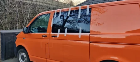

So today has gone better than the other day! I have a window on the van and it didn't destroy itself! Wether it leaks we will see tomorrow!

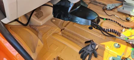

Also finished grinding out the bulkhead and got that painted and also took out the rubber mat to give it a good clean! It has come up quite well. The floor underneath had about a 1cm tall mound of dirt from where the RAC drivers must have rested their foot!

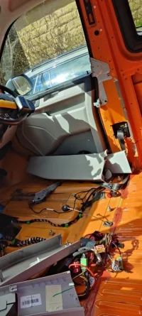

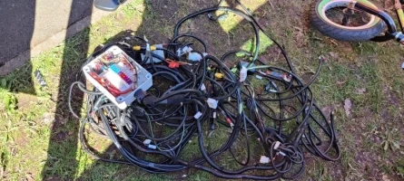

So the window doesn't leak!! So at least we don't have that to redo. Managed to remove the last of the wiring! Had two wires running through the bulk head, I presumed one was the battery cable but didn't know what the other one was. Ended up removing the battery, arch liner, and half the bumper trying to trace the last one! Ended up an hour later finding it had been cut at the other end anyway!
Left the battery wire and rerouted to under the driver's seat ready for whatever electrics I do.
Then got the rubber flooring back in and seats back down ready to drive to work tomorrow. Ended up finishing it as dark was falling so couldn't get pictures of the nice clean floor!

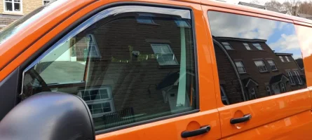

So not achieved much lately due to it being Easter holidays and the weather has been a bit poo. But did get my Climair wind deflectors fitted after asking on here about the screws.

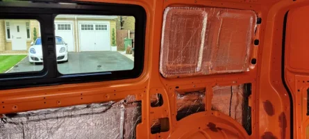

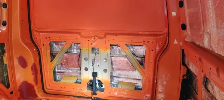

Then today been sound deadening and insulating:
Had to do it with a helper:

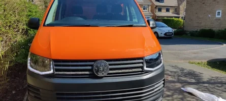

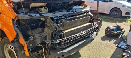

New headlights arrived yesterday and with the kids back at school I had most of the day to myself.
Really pleased with them, just need to get the dip and main coding done.
While I had the bumper off I removed the chrome strips to spray them and resprayed the badge with the textured truck bed liner spray.
Also managed to get one wheel arch sound deadened from the outside. Get the next one done tomorrow hopefully.

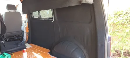

I started carpeting today! Overall went ok, few bits are not as good as I wanted but I started with the side that will be hidden by the kitchen so hopefully when I do the other side tomorrow it will be better! I have left a section hanging down for when the pop top gets fitted. Hopefully there is enough and I don't have to get some more and try and join it.
We have got some panels to go back on when I have fitted some bottle insulation and ran some wires.

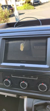

So not updated this for nearly two weeks so thought I would, although not done loads. Went to Chris @Dav-Tec on Friday and he fitted a new headunit and reversing camera for me.
Unfortunately in doing so he uncovered some rust around where the previous reversing camera had been so some more work for the body shop! Hopefully I am going to speak to one next week and see what they say/ quote, the previous local one hasn't got back to me.

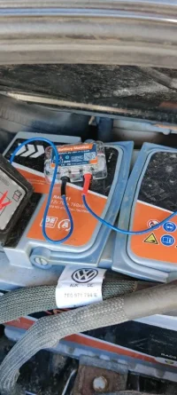

I fitted a battery monitor for the starter battery today:

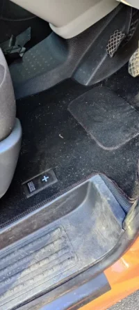

Finally I added a little bit of comfort in the front, although it's filthy already:

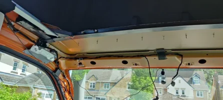

So took the headlining out today so I could finish off the carpet at the front of the poptop and then also sound deaden and insulate what's left of the roof.
Apparently I didn't take any photos of the after! Tried fitting the sunglasses holder but realised after I made the holes and wondering why it wouldn't fit, then reading forum posts that I need the bracket attachment thingy like the other side! So left that for another day, annoying I now have holes in the headlining!

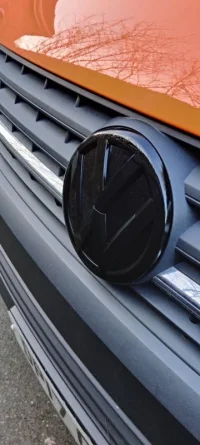

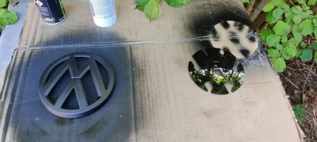

Didn't like the orange front badge so I have sprayed that and the badge.

So gave it a wash today and fitted the now black badge

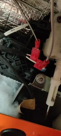

Bought some more insulation from b&q this morning to finish off the tailgate and passenger side. Also received some t tap connectors and button in the post for a tailgate switch.
Thought I had ordered a larger one but hopefully this way it's less likely to be pushed accidentally. Anyways it works so pleased with that.

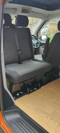

So finally the seats are in!! Pictures sent from the fitters:

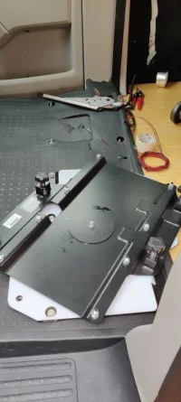

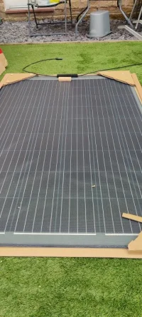

Next jobs are swivel base fitting, solar panel hopefully at the weekend/ beginning of next week, then maybe some more electrics if I can work out where it is going to live, as it won't fit under the driver's seat.
