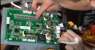

not you exact battery. . but a Renogy 48v 50ah BMS , but it shows the balance resistors and balance leads.
this may be yours?
"100Amp BMS By the markings anyway. Looks cheap as
Construction looks very tidy.
couple temp sensors just floating up top.
Sadly after only about 20 cycles the battery wont accept any more amps after it hits around 13.68V it just drops out completely. after fully charging it and full draining it multiple times it will not provide more then around 25Amps now. Thinking the BMS is triggering some sort of "High Voltage" cut off far lower than 14.6v

this looks like the balance section of the BMS. . . .
but reading the above. . .
it looks like running the battery low triggers the BMS shutdown.
TBH, it looks like a very early battery. . . . where lithium and BMS tech is still being developed.
it may be best to just fit a newer more modern 100ah version into the van.
and just pklay with this 50Ah pair on the bench for other bits.
i think you will have no end of repeat problems unless you can 100% unsure that you keep the battery withing its charge range to prevent the BMS shut down.
