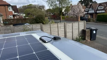

Yeah, the cables are quite short, and there would be less contact between the panel and the Van roof if it was in the middle, just because of the width of the ridges.I've got what I believe is the same panel to fit. Any reason for not fitting centrally on the roof?.
Edit: I assume because of where you have fed your cables?

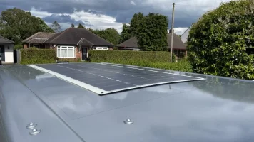

I’ve got the same 200w panel and it’s been great for the year I’ve had it. I’ve seen just over 200w in summer sun. Attached to the poptop with Sikaflex on a piece of PPF just in case it ever needs replacing. I’ve ensured there is a 4-5mm gap below it to give a degree of airflow.How's this 200w Renogy flexible solar panel going 2 years down the line? I'm looking at one at the moment, just wondered how the reliability was?

Have you a picture of the the rear cable @ginkster please.I’ve got the same 200w panel and it’s been great for the year I’ve had it. I’ve seen just over 200w in summer sun. Attached to the poptop with Sikaflex on a piece of PPF just in case it ever needs replacing. I’ve ensured there is a 4-5mm gap below it to give a degree of airflow.
Here you go. I used a Scanstrut glad, a fantastic piece of kit and worth every penny. Cables routed through the main cable gaiter too left of the tailgate. If I did it again I would probably route inside the tent or take the cables in down by the rear light.Have you a picture of the the rear cable @ginkster please.
