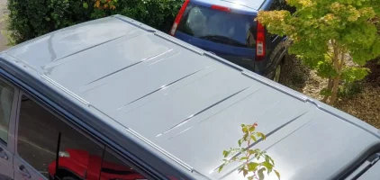

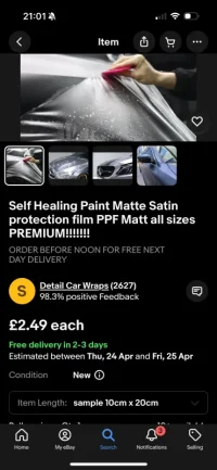

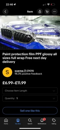

I put down a sheet of PPF and the keyed the surfaces with a scotch pad before using Sika 552 to stick the panel down. I applied a 8-10mm triangular bead (instructions on Sika website) to give a 4-5mm deep bead once the panel was applied. I also used a few rubber spacers to ensure the panel didn’t get pushed down too far - I wouldn’t bother next time. The beads are full width at the front then the rest run across the panel but have a 10-15cm gap in the middle to aid airflow and to allow any water to escape. They are placed at about 15cm apart to fall in the gaps between individual cells. The front edge is smoothed so there is no edge to lift in the airflow. It’s survived all weathers and high speeds no problem at all and is in the same state it was when fitted.
