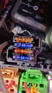

So checking my notes there is a block of 4 fuses in fusebox SK.
The first thing I noticed when I did my fuse card was that the current flow diagrams show this block as SK5,6,7,8 but on my van it seems to be in position SK1,2,3,4 - I guess this saves having to add the extension frame if that block in the standard frame isn't used.
So I have on my card:
SK5 (1?) 15A Power Latch Right
SK6 (2?) 5A Rear Right Door Protection
SK7 (3?) 15A Power Latch Left
SK8 (4?) 30A Rear Left Door Protection (why not 5A?)
I had noticed the odd 30A vs 5A on SK8/4 but think I had put it down as possibly down to being wrong about the transposed block of fuses.
Does that fit your recollection of the work done on your van @VioletVW ?

Some as mine then, I'm sure it's swapping the 30A for 5A on the left door protection circuit I noted in the post above.
We're roadtripping this weekend so will stick my head under the seat and confirm in the morning.
Nope, it's very minor they've just used a 30A fuse on a 5A circuit - the only edge possibility is in case of a fault the wire might melt before the fuse blew.
Just for confirmation it was the fuse I noted as odd writing out a fuse card for my van as noted above.
Very simple fix doesn't really need a dealer visit!
