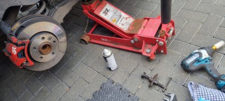

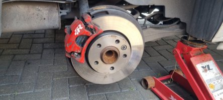

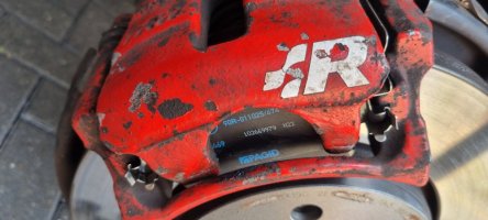

took the wheel off to check and it seems it might be the brake callipers?, there is slight movement in the calliper on the slide pins. . . possibly causing them to chatter from the vibration of the wheel/tyre over floor bumps?
not 100% sure yet . . . but the recent work to be done since it started is rear discs & pads ( Brembo ) . . . plus tow bar - so its plausible.
plus I've not used the brembo kit before - im normaly OEM if VWCV do it, or Pagid from ECP if im doing it.
just ordered a replacement set of pads that i normally use (Pagid), ill swap them out and retest.

Swapped out the rear pads yesterday.
Let's see what happens....?
A quick drive round the block confirmed the suspission as the chatter clank has now disappeared.
Now to see what happen in a couple hundred miles time .

Lower spring sear rubber looks like it’s shot. Also remove the shock and redo the test drive. Those shocks look tired
Lee has the rod snapped on the shock absorber, I know it looks like the shock is compressing in a straight line in the video but just sounds like the rattle you would get if only either end of the shock was connected separately and the two halves chattering in the middle within the dirt shroud?

I've edited above as I swapped the pads over the other day.. all looked ok.
I wound the piston s back a few turns and fitted new pads.
It's almost like the pistons we pulling back slightly giving enough of a gap to allow the calliper to wrattle....
ill give it a week or two and see what happens.
this clip shows the calliper movement on the slide pins before the play was closed up by pressing the brake peddle a few times . . (after installing the new pads)

Fixed mine. Pads were loose in the carrier. There was about 1mm clearance in both directions. Pads and discs were new last year. The rattle springs weren't doing their job. I gave the springs a bit of a bend to hold the pads and the noise has gone.
