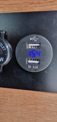

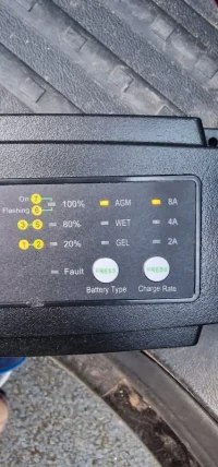

Hello wonder if someone can let me know if this is OK? I have a rayne automotive 8a battery charger. I've test fitted everything and plugged the charger in just to make sure it's working OK. When the charger is plugged in it slowly brings the charge of the battery up to 15.4 volts, if I put the lights on it does drop to below 15v. I have a 95 amp agm enduroline battery and it is vented. My worry is that from what I have read 15.4 volts is too high. So is this safe to use? The battery is vented to the outside of the van but obviously I don't want it going bang in the night
That is a bit too high !
Not familiar with the charger but whats the options/settings for different battery types ?
Have you got a multimeter or something that could confirm what output its giving and thus confirm the accuracy of your onboard voltmeter ?
Just checked the manufacturers website and nothing on the product page that specifies what voltage it is supposed to output for each battery type but it does state its not suitable for lithium which is normally the high voltage of all the batteries so something defo doesnt sound right
I would get that voltage confirmed with a second device then either replace the charger or the onboard voltmeter as one of them isnt right
as @Pauly said.
get a multi-meter on the battery to double check the actual voltage. ( id imagine that USB meter is off a bit , maybe a volt ?)

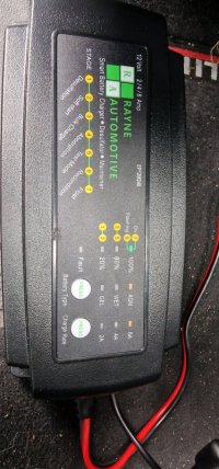

it looks like the charger is in BULK mode, so throwing max available power at the battery ( due to no 20/80/100 led being lit)
15.0v is ok for a AGM SLA battery at room temp,
and can creep higher if its cold and the charger has charge-temp-coefficient.

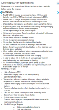

found the instructions. . .
looks like its a white lable EVERPOWER charger.
RAYNE : EP12m248
rayne 8A Mains Battery Charger instructions
rayne 8A Mains Battery Charger pdf

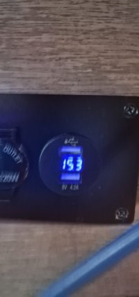

Hello thanks for the replies. Sorry should have said I got the picture as the light was flashing on stage on stage 6 stupidly i didn't retake it to show that. I'll get a multimeter on it tomorrow when i get the chance and check what the voltage is of the battery. If it's still 15.4v should i take that that it is ok or get another charger on it?
The charger spec looks ok.
Check with a multimeter first.
I'd image things are ok and the USB meter thing is just a bit off.

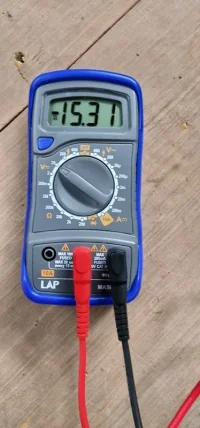

Got a multimeter on it this morning. Same thing as before gradually build s up to the voltage. Multimeter shows 15.31 and USB one show 15.4. Charger is on agm 8a charge and green light flashing on stage 6. So is it safe to use? Or will I damage the battery? Or worse
