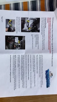

Im new to this site and after some technical help . I've fitted the travelin lite genuine electric folding mirror kit to my t6 2015 highline kombi and have got to the final connection stage. My issue is connecting the positive 'on' connection as the wiring info states a thick black and yellow wire that feeds lighting switch to make connection. This isn't present on my vehicle and im unsure where to connect. I've tired to call technical help line but no reply. Any help would be appreciated thanks lee.
