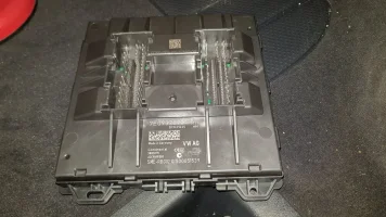

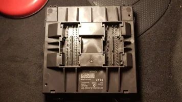

What is your BCM?
Can you post complete info?
Not sure if this is any help - a scan of an early T6 (MY16) in the UK - has left and right electric sliders.
---> RNS510 bluetooth
Part No SW: 7E0 937 090 HW: 7E0 937 090
Component: BCM PQ25 Max4 H80 0736
Have added that into the coding comparison and virtually identical to my current coding, all differences accounted for
According to my knowledge your BCM is definitely compatible with electric sliding doors on both sides.
Actually mine factory fitted BCM is almost identical to yours.
If coding/adaptations tweaks fail I am happy to post my spare(original) BCM over to you for testing purposes.
The only condition is that I need it back (for my experiments :whistle:).
