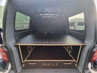

This is exactly (Well, near as dammit) what I have been sketching on envelopes for a couple of years now! Do you have any plans for it?
Sorry for the delay in replying, real life getting in the way.This is exactly (Well, near as dammit) what I have been sketching on envelopes for a couple of years now! Do you have any plans for it?
Where did you source the drawer slides from and which ones exactly?
It looks fantastic and fits to the legs of the Kombi bed? The furthest I got with the slides about 6 months ago was about £400 per pair! I ran away from the project at that point.

Thanks for your reply! Real life getting in my way too so completely understand. Thanks for the really useful information regarding ply and runners. You have enabled a huge step closer to my building something. Thank you kindly.Sorry for the delay in replying, real life getting in the way.
no plans I’m afraid. I just sketch, measure and cut
The main sliders are these:
AOLISHENG Heavy Duty Drawer Runners with Lock 1200mm Full Extension Load Capacity 150 Kg Ball Bearing Long Industrial Locking Drawer Slides Side Mount 1 Pair (with Lock, 48 inch (1200mm)) https://amzn.eu/d/8rzy5BD
wood is 18mm ply.

View attachment 146455View attachment 146456View attachment 146457
Nice van mate. How much 18mm ply did you use? Thinking of something similar but don't know how much timber to get.
