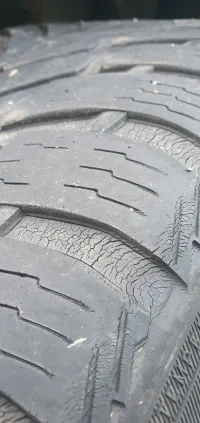

Nokian Weatherproof - Not ageing well.
Wales and Scotland are hardly hot countries :)
The rears are fine. I’m also a bit of a pressure pedant - I forget how many times I’ve told people they have flat or under inflated tyres. I’ve always increased the pressure when loaded (holidays) and reduced them afterwards. That said, 235/50R18 isnt an OEM size fitment so use the closest size on the label to set the pressures.
The other thought is geometry so I’m going to get it checked.
The tread block does seem like its cracking and the rubber hasn’t been baked properly.

It does seem your tyres have the same wear pattern as mine. However I'd prefer to be binning (sorry...recycling) my tyres because they'd reached 3mm, rather than the structure of the tyre degrading. It appears mine are not an isolated case either.

the previous wear has been even across the board. The problem appears to be the rather abrupt breakdown in integrity of the compound on the tyres shoulder, hence the cracking and perishing. The shoulder wear on your tyres actually looks more severe than mine. Yet we both believe underinflation hasn't been an issue and the axle loading has been under load index 104 apparent capabilities.
As you've said yourself Chris, the wear pattern is 'slightly strange'. Personally, I find the perishing and cracking 'slightly strange.' Others too, have reported and posted on the tinterweb, also seem to find the failing in compound 'slightly strange'. Hence their posts. And some reports from consumers, suggest Nokian themselves maybe keen on getting tyres with this defect off the roads, by offering warranty replacements.

Close up of one of the rear tyres. Fairly even wear across the board. 5mm tread left. Spot the the bit that's doing the wearing. Spot the bit that's doing the failing.
