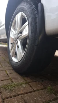

47C656B3-8975-43B7-94F8-CF49914981E5.webp Handy hints and top tips folks, and apologies if this has been mentioned before (I did search) If you are fitting the rear mud flaps from veedub transporters (which fitted very well I might add) but initialy I imagined the top edge would be placed where the bumper meets the quarter panel, wrong was I !! You will need to fit it so that the top edge of the mud flap is around 15mm down from the top edge of the bumper as in the pic, this will ensure that the mud flaps sit square to the wheel, made this mistake when fitting the first one which was easily rectified, but anyways thought this might help someone from making the same mistake as me, cos if you fit them sqint you will be kicking yourself and your van will look like a circus
I fitted mine so that they were at the top of the bumper and the bottom of the mud flap is square to the road. They do taper out slightly but no different to the OEM ones fitted to our Yeti. The only issue I have is that they are not wide enough to cover the inside of the wheel....they do a very good job of keeping the road cack off the paintwork though. It's worth noting that I have my summer wheels on at the moment (18" with 255s) and these do sit further out. Maybe it will look like a clown car when the standard 17"s go back on next month!
Thats great yours fitted at the top of the bumper , I just assumed that this would be the case too , anyhoo got them on now and they look square, perhaps it would be a good idea to get someone to eyeball them as you hold them in position, then you would know fo-sho before you fixed them, another top tip is to give them a once over with some tyre wall shine, this made them come up nice and black, all I need now is a small VW badge or decal to fit on each of the rear mud flaps
