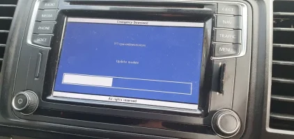

-applying MST2_EU_VW_PQ_P0478T_3G0919360JL (downgrading)
in "service mode" / "test mode" / "SWDL" / "Toggle MANUAL"(touch manual, 1 time) / "download" / "select all" / "install".

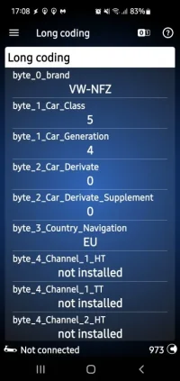

-verify in 5F / long coding / byte 0-2 is set to crafter

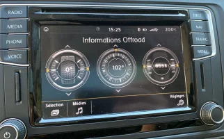

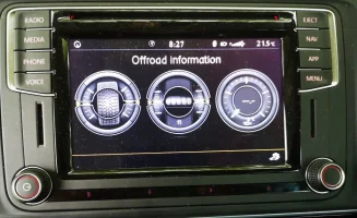

Show Off
be careful to align left and right of your image to fit exactly the crafter horizontaly!
same for this one, align perfectly the nose and the tail of the car !
I will maybe mod park pilot to paint my multivan in blue
I need to activate sport mode, but it seems to be more difficult
