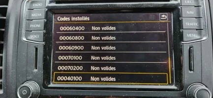

I managed to switch to 478 but I no longer have any fec/swap codes
that works
a little help to clear or activate everything
thanks gerry

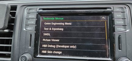

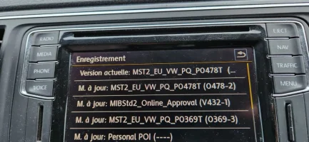

lasts hours:
-applying MST2_EU_VW_PQ_P0478T_3G0919360JL (downgrading)
in "service mode" / "test mode" / "SWDL" / "Toggle MANUAL"(touch manual, 1 time) / "download" / "select all" / "install".
-install mibtools again
-verify in 5F / long coding / byte 0-2 is set to crafter
-install VW_PQ_P0478_FEC_ALL_CID_OFF_CP_OFF_SKIN_FIXED
-copy skins to SD : test mode / GEM / mib2tools / dump / skin
-put SD in computer
-extract skins with
-put skin with my car instead of the crafter ones (sometimes I was not sure, I replaced the "MAN" too )
-compress the mcf with new images:
put skin on SD:
put SD in car, copy skin to car:
GEM/mib2tools/tool/customization/skins/copy from /custom/skins

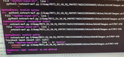

Hello
I can't extract the images.mcf file
after many attempts
a little help
thanks gerry
thank you j 'arrived there @Robert
But I have my ops who disappeared
When I injected the images
How to solve this problem
Or if someone has the original ( images . mcf) file of t6 I am interested
thank gerry

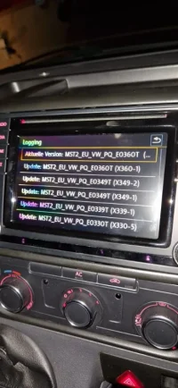

Hello, I tried to update the navigation system at my friend's place over the weekend. Unfortunately, I couldn't install the toolbox. Do you have a solution? He has retrofitted the MIB2 in his T5, but the MIB2 is a test device and has the software version E0360T.
