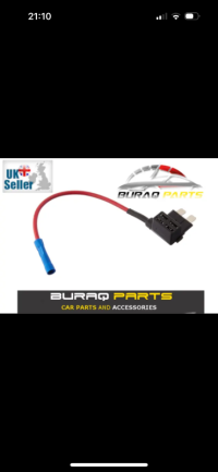

I’ve got everything in and now just need to find which position in the fuse box next to battery is an ignition feed to get the bonnet and bumper DRLs working with the ignition.
I’m going to pick up a piggy back fuse thingymabob tomorrow to just pug into the fuse box.

Thanks.
I will just have to try them out by trial and error until I find one I think.
Failing that is the any wires under the bonnet that are ignition live feeds?
Thanks.
