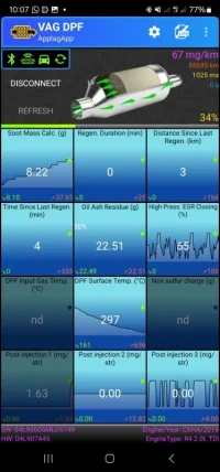

Checking the VAG DPF App, it showed the DPF was defo needing a clear out (regen)...
So after 10-15 mins down the motorway, all cleared (but only goes down to 33-34% after regen these days)
