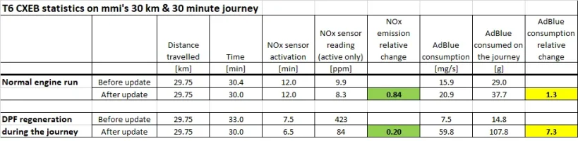

Statistics - short term​
Basically just pictures 1-4 above converted to dull numbers​
All the runs were as identical as possible along other traffic - same route, thus same uphills/downhills, stops, etc. Average speed about 60 km/h.​
NOx sensor readings are average over only over sensor's active period - otherwise the values would be too "diluted" by initial inactivity.​
Also worth to note that DPF regeneration didn't last full journey - thus the values are a bit diluted by non-regen time - approx. 10 minutes from end. Also might be of interest that DPF regen was due when setting off thus maximum heat-up from cold engine (+10..+15C)​
Well, jumping into conclusions based on just one set of measurements:​
Typically, using the driving profile above a full DPF regeneration cycle would consist of​
7 x normal engine runs (each 30 km)​
1 x DPF regeneration during the journey (each 30 km)​
thus AdBlue consumed would have been​
BEFORE the update: 7 x 29.0 grams + 1 x 14.8 grams = TOTAL 218 grams
AFTER the update: 7 x 37.7 grams + 1 x 107.8 grams = TOTAL 372 grams
The numbers interestingly show an increase of approx. 70% in AdBLue consumption thanks to the ECU update​
Not scientifically accurate but a kind of pinpoints where the culprit for the increased consumption is.​
Certainly should have taken into account now (after update) less frequent DPF regenerations (see part 4), which actually worsens the numbers a bit.​
Conclusions about short term statistics​
(1) For normal engine run - by the ECU update NOx emission were reduced by 16% However the AdBlue consumption did increase by 30%.​
(2) For the DPF regeneration the numbers are quite drastic. The update reduced NOx emissions by 80%. However, for this journey 7.3 times more AdBlue was consumed - mainly because before the ECU update, no AdBlue was used during DPF regeneration.​

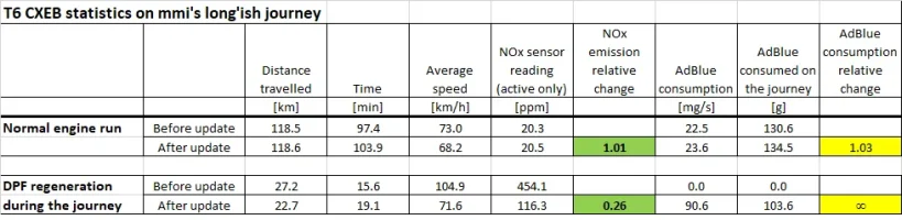

Statistics - medium term​
No pictures... unless...​
Another set of statistics - for a fairly long drive - just to dilute engine cold start effects on NOx emissions - possibly addressed by ECU update (see above "Short term stats") - possibly related to infamous P20EE fault code in early days of T6.​
In this data the "DPF regeneration" period has been isolated from the data (different journeys than "Normal engine run" here) - also the DPF regen started on route when engine had been up to normal operating temperature for a while already - thus slightly different case than in short term stats​
Conclusions about medium term statistics​
(1) For normal engine run - the NOx emission seem to be unaffected by the ECU update.​
(2) For the DPF regeneration - quite a difference before and after the ECU update both in NOx emissions and AdBlue consumption. Quite a significant burst of AdBlue now during the DPF regen. Not to mention about extra squirt of diesel...​

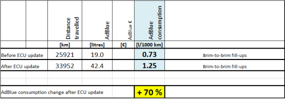

Brim-to-brim AdBlue fill-ups were noted down before and after the ECU update. 19 months before, and 24 months after the ECU update​
0.73 litres/1000 km = 3880 mpg​
1.25 litres/1000 km = 2260 mpg​
Conclusions about long term statistics​
Indeed, there was a slight increase in AdBlue consumption....​
