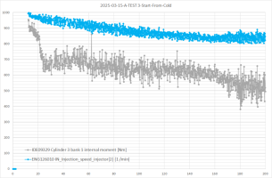

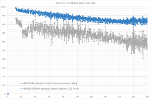

TEST 3 LOG-01-IDE09327_&11-Start-From-Cold.CSV

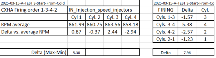

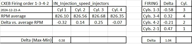

Still seems to be the same/similar as in post #43 (2025-01-27 LOG-06) - at the startup "cylinder 4 internal moment" (calculated by ECU) lags compared with cylinders 1-3.
Just a note: there was a small gap in the data stream thus missing samples between 2.33 and 12.11 seconds.

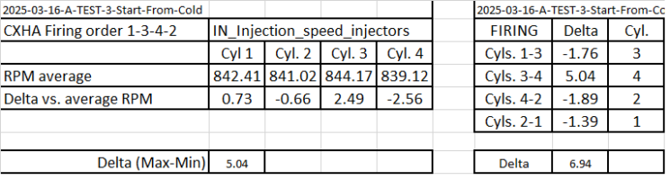

Not sure if the "statistics" below are anything useful/meaningful - at the moment. Obviously need to do comparisons with supposedly good engines...

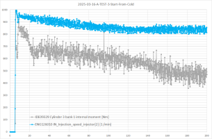

Your wish :) Done another log this morning when starting.
TEST-3-2025-03-16-LOG-01-IDE09327_&11-Start-From-Cold.CSV (attached) :)
After this log, I revved van and it seems to clear lumpiness. Could it be as simple as a glow plug in cyl 4 causing this? :/

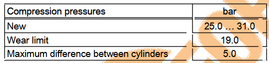

When spoke to manager today he said they done a compression test, and all cylinders were within tolerances. But believe it was done when engine had heated up, but this was normal. Rather than doing it when it was cold.... , said cylinder 4 was at 22 (bar?) which was the lowest of all cylinders but still within tolerances. He said it can go down to 19 before issue .....
May need them to do the compression test when engine is cold, to see variations between cylinders?
I've said that to them, they have said they have a set procedure for testing and that includes it being warm.... But are going to retest, and hopefully will leave it in garage the night before testing.......

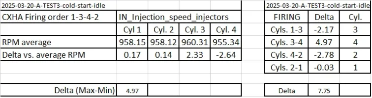

TEST3-2025-03-20-LOG-01-IDE09327_&11-cold-start-idle.CSV
I think it's consistent with data gathered earlier. Although somewhat similar behaviour now briefly in cylinder 2 - which was not noticeable before. Perhaps just carried over from cylinder 4 (because of firing order 1-3-4-2).
