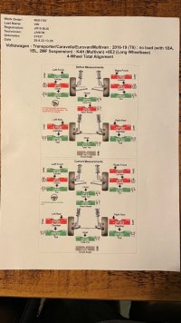

Just seen this after reading backwards through the thread. Will this eliminate the wheel drag from the drivers wheel i feel when turning left. Thanks for the infoTo all of those struggling with alignment issues hopefully this helps. These two print outs are from when I first lowered my van and had the alignment done on the automatic setting, and then when I took it back and asked them to override the system and do the alignment on the "no load" setting.
You can see that when I lowered the van the toe in at the rear was a huge 0'56. The automatic alignment setting reduced this to 0'32 which was an improvement, however, you will also see it is still a lot more than the front which was at 0'12.
After taking it back and getting it done again with "no load", you can see the rear toe in comes down to 0'18 which is significantly closer to the front 0'12. The 0'18 is also well within standard spec so tyre wear is well within what you would normally expect. Explaining all of this to a tyre fitter can be a bit of a job, as they are ultimately the professionals, so hopefully the below pics help.
@CRS PerformanceFrom that print out I would guess that the van is lower than 50 mm. Some settings camber and castor are out of spec but only slightly , these are not adjustable of course without special adjustable bushes designed to give more adjustment on camber and castor , measure the wheel arch gaps for me let’s see if it is too low or maybe you have worn control arm bushes
