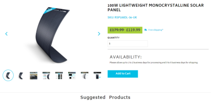

£120 for 100w panel
and
£224 for 50A DC-DC + MPPT.
and you get discount from the link:
I can get you a discount at Renogy United Kingdom
thank you so much for this detailed reply and for the discount
Buy a cheap flexi panel and it will fail. Our original motorhome still has the 300 watts worth of flexi panels on fitted in 2013. The van lives outside 247 here in Spain! Without problems, still giving loads of amps. I fitted a 200watt flexi panel to the camper van we have now, back end of last year without worries about failing.
do you mind sharing the brand? thanks
Sure, this is the current one on my camper. Took about 2 hours start to finish fitting time. Worst bit drilling the hole........ As I'm in Spain a little cheaper than UK prices, but here is a UK link, however shop around. Today as I write this in the camper I'm getting 10amps from sun (sometimes get up to 12amps) at 11:25am using Victron MPPT. This morning used electric kettle 3 times, cooked breakfast on induction hob, all via inverter. The battery is already fully charged.
